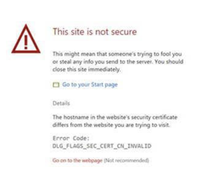

It has https but sometimes when users try to visit the site they get this message.
This site is not secure
This might mean that someones trying to fool you or steal any info you send to the server. You should close this site immediately.
In case you have not yet noticed:
thinkplanner.se & www.thinkplanner.se both resolve to:18.188.17.87
However, the cert at 18.188.17.87 only has one of those names on it.
The other name will fail with that error; as the CN, nor the SAN, donβt cover that other name.
If you ran certbot, with: -d thinkplanner.se
then make that: -d thinkplanner.se -d www.thinkplanner.se
[adjust for your particular ACME client syntax/requirement]
