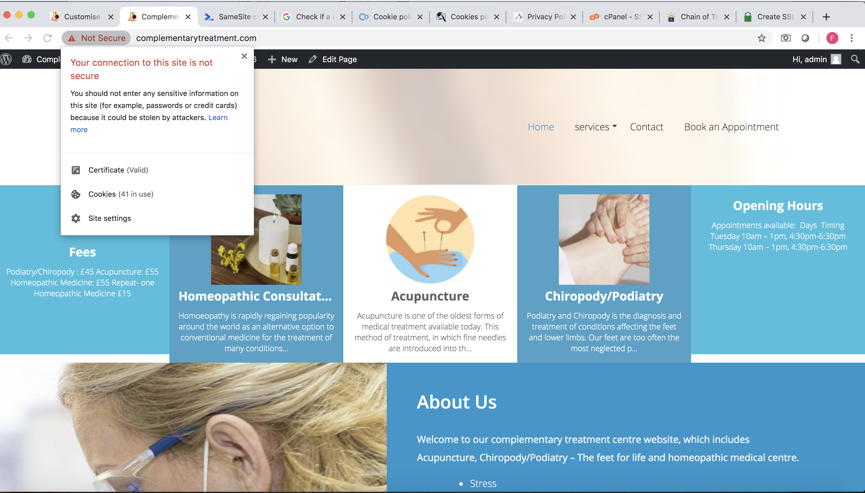

I checked the website on windows without admin login , and it came as secured. Is it some problem with admin or with mac?
Here is the screen shot of ‘not secure’ screen.

Looks like your admin account has additional objects, so you have a mixed content.
I don't use mac. Is there a console (Ctrl + Shift + I)? Or is it possible to open the site (as admin) with a Chrome or FireFox? Then use Ctrl + Shift + I to check, if there are additional informations.

I checked the console on mac. Here is image of console opened with admin login.
What says “Security”? There must be an error.
But sometimes browsers show incomplete sources of mixed content.
Is it https?
yes, it is https. Website is coming fine on safari too. It is on chrome where it keeps on showing not secure.
