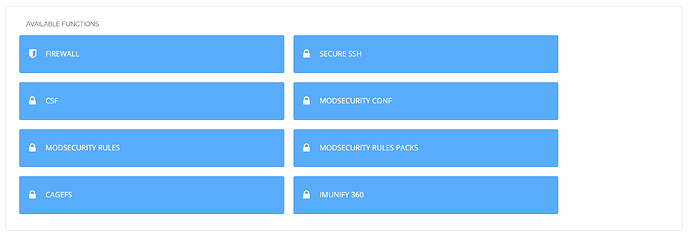

Something on your system is rejecting the ACME HTTP Challenge with an HTTP 403 error (Forbidden).
I can easily reproduce this just using curl requests. You need to review your system config to see why it forbids these requests. Check your LiteSpeed server and any routers or firewalls.

I've already reached out to them. I tried installing through CyberPanel, but it keeps on assigning the self-signed SSL after failing to issue a complete one.
