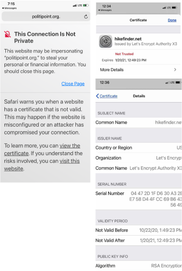

My goal was to set up 2 different domains (politipoint.org and hikefinder.net) pointing to 2 different sites on the same server with ssl, nginx, and using a reverse proxy in my config. I thought I had it working. But the user reported the following (screenshots from her iphone/safari)
https://res.cloudinary.com/fergusdev/image/upload/v1603913157/politipoint/error/ios_pol_vtissv.png
So, it looks like when she went to politipoint.org, it incorrectly looked at the hikefinder.net certificate, likely causing the error?
I have since removed the hikefinder.net certificate and references to hikefinder.net in my nginx configs, as it is not as important currently and removing that variable. Her phone should only find the politipoint.org certificate now.

The online check can't reproduce that result. There the certificate is correct.
What's the time zone of that screenshot (how old)? Did you change your configuration later?
the screenshot showing hikefinder.net is from 2 hours ago, 11:30am mtn. I have not gotten a test / screenshot from her since I deleted the hikefinder.net certificate and removed hikefinder.net from my nginx configs.
if it works for her now, i will know something.
