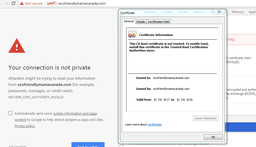

I installed the plug in WP Encrypt on WP and plugged all my info clicked generate certificate and was given 4 lines of certificate and key locations. Didn’t know what to do with it so I called godaddy (my host) and then proceeded to follow the steps to get my CRT. I thought I missed a step when I put in all my info on the WP Encrypt so I deactivated it and deleted all the info and tried again from the beginning but now it says “Challenge request failed for domain ecofriendlymamacanada.com” I’m not sure where to go from here or where to plug in my Certificate request info. I believe my operating system is OS X 10.9.5. My website looks fine in Safari but with Chrome it says “Your connection is not private…” NET::ERR_CERT_AUTHORITY_INVALID

The certificate for https://ecofriendlymamacanada.com/ is self-signed from what I can tell. I’m not familiar with WP Encrypt, though, so you might want to ask the developer of that extension.

I didn’t pay for an SSL so I got a self assigned one @motoko. I’m trying to generate a .crt file that I can plug into my go daddy SSL certificate that I thought I was going to get through WP Encrypt (let’s encrypt via WP) and I can’t seem to get one. I don’t know what I need to do
The certificate has been issued successfully:
https://crt.sh/?Identity=%ecofriendlymamacanada.com&iCAID=16418
So if it’s not correctly installed in your setup, I would suggest asking support for whoever seems most responsible (which might be GoDaddy—I’m not quite sure how to break down the responsibility here).
Thanks for your reply. I do see that I have a certificate but I was under the impression I had to have a .crt file to upload to my host. Godaddy sent me this article to help me but I’m not seeing a .crt file anywhere also I didn’t have to submit my CSR to let’s encrypt and from what I’m reading that’s what I needed to do as well. Is there something else I’m missing or another article I could read
