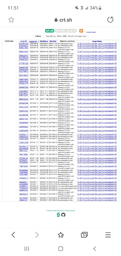

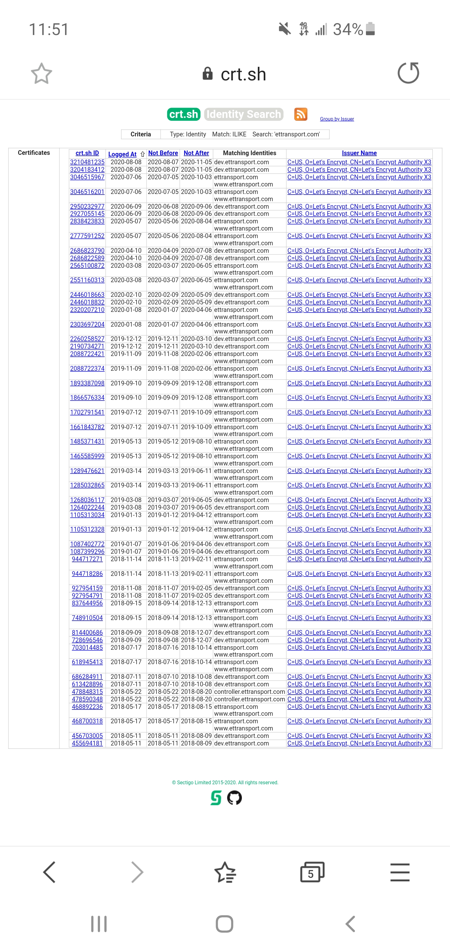

I’ll try to help you out. Looking at the history of certificates for ettransport.com, I can see that you have 2 unexpired Let’s Encrypt certificates that have been automatically renewing every 60 days as normal:
Your domain registration with GoDaddy for ettransport.com is set to expire at 17:30:33 UTC on 9/12/2020, but might be set up for automatic renewal. I’m not sure about the expiration status for the hosting of your website.
It looks like ettransport.com and www.ettransport.com are still serving a certificate that expired on 8/4 even though a new certificate was generated that expires on 10/3. Similarly, dev.ettransport.com is still serving a certificate that expired on 7/8 even though 2 new certificates were generated that expire on 9/6 and 11/5.
Did you recently change server setups for your website?
https://crt.sh/?q=ettransport.com
