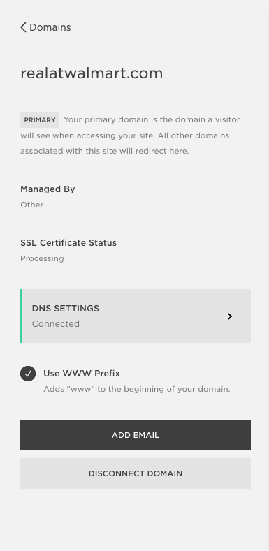

Squarespace SSL Not Being Issued
My domain is: realatwalmart.com
I ran this command: Squarespace site
It produced this output: Processing
My web server is (include version):N/A
The operating system my web server runs on is (include version): N/A
My hosting provider, if applicable, is: Squarespace
I can login to a root shell on my machine (yes or no, or I don’t know): N/A
I’m using a control panel to manage my site (no, or provide the name and version of the control panel): N/A
I’m trying to get the SSL certificate assigned to this site and the Squarespace team has told me to reach out here since the issue is that the domain itself has a top keyword. However, I work for Walmart and need this domain to be secured as it’s for a recruiting microsite that we quickly built out on Squarespace. Is there anything that can be done in order to whitelist this domain so that on the Squarespace settings page the SSL can be issued. Thanks!

Yep that’s the exact domain. And the site is properly connected from our DNS manager to the site itself just waiting for the SSL. I’ll follow-up with the Squarespace team, but is there any way to just get the certificate forced processed through this forum? Or is there an error that you’re expecting to be the issue?

Finally it’s all working! Thank you so much for your help with this!!
