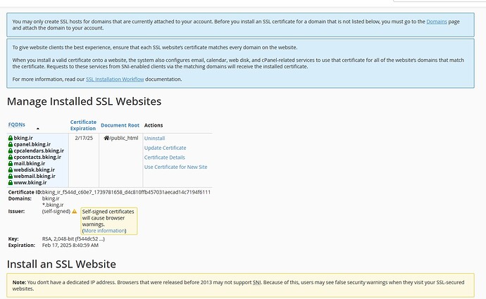

In the past two months, all of a sudden, no SSL certificate was issued for our sites, and all autossl certificates were issued as self-signin, which resulted in errors in browsers.

Yes, we used autossl many times, but if you open the mentioned domains, you will find that the self certificate is only issued, which is not valid for browsers.

For more detailed explanations in the certificate update, the Certificate Authority Bundle: (CABUNDLE) section remains empty and does not autofill.
