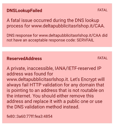

There was a problem with your DNS in trying to access your CAA record, so Let's Encrypt cannot determine if it is authorized to issue a certificate for www.deltapubblicitasrlshop.it. This issue could be sporadic as it appears to me that you don't have a CAA record.
It also looks like www.deltapubblicitasrlshop.it is using a private IPv6 address (AAAA fe80::3a60:77ff:fea3:4854) and thus Let's Encrypt won't be able to reach it to verify your control of the domain. You will need to either change that address to a public IP address that reaches www.deltapubblicitasrlshop.it or remove it.

You should remove the AAAA record from your domain name.

I am consistently getting a variety of DNS errors trying to look up records for deltapubblicitasrlshop.it and www.deltapubblicitasrlshop.it. Is there a problem with your DNS provider?
For deltapubblicitasrlshop.it...
For www.deltapubblicitasrlshop.it...
I don't know, i will ask my provider if something is wrong. But the setup in theory have to be correct. I'll check
Then your webroot is wrong or you have additional definitions.
Your validation file doesn't work.
We're more than happy to help with your setup, but if Let's Encrypt is seeing anything like what Let's Debug is seeing, that's definitely the primary concern.
When I use https://toolbox.googleapps.com/apps/dig/ though, I'm getting records consistently.
