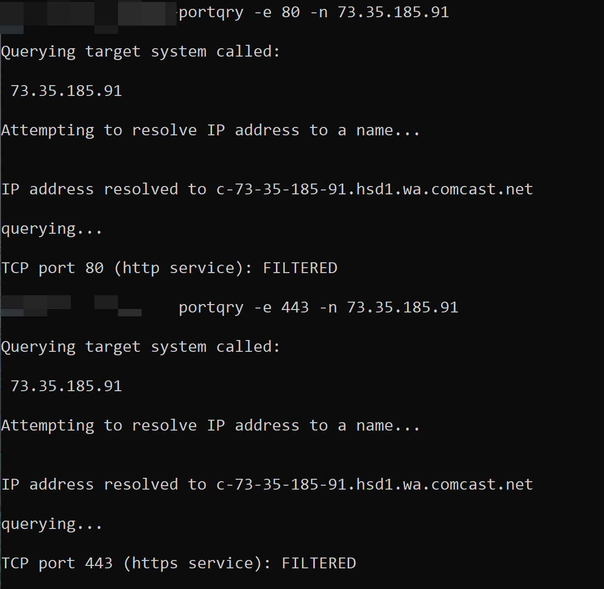

Mine is a Synology NAS at home and hard wired to one of the Wifi Routers (Mesh setup). I'm not using an Xfinity router or their gateway but I know their gateway sometimes has connection restrictions.
Maybe it's time to give Xfinity a call? Perhaps they have some restriction on your account or router. (Just random thought)
P.S. Both port 80 and 443 are shown as filtered from my port test.
