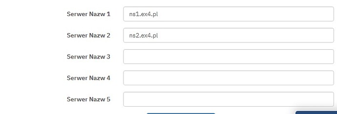

Unfortunately my domain registrar doesn't let me update anything more than name servers.
Hi @lindey
Than your registrar will need to update the records for you If you must use a DNS Challenge. They will also need to add the "random string" certbot gives you once you have it.
_acme-challenge.drogeriazoya.pl TXT
I know nothing about Direct Admin but I think you might find your solution there.
I think it's fairly common for DNS hosting to not actually be associated with the registrar? The registrar needs to let you set what DNS servers you use, but it's quite common for those to be a different company than the registrar itself.
If the nameservers are on ex4.pl, then whatever company owns those (which might be integrated with the hosting) is what needs to get updated.
