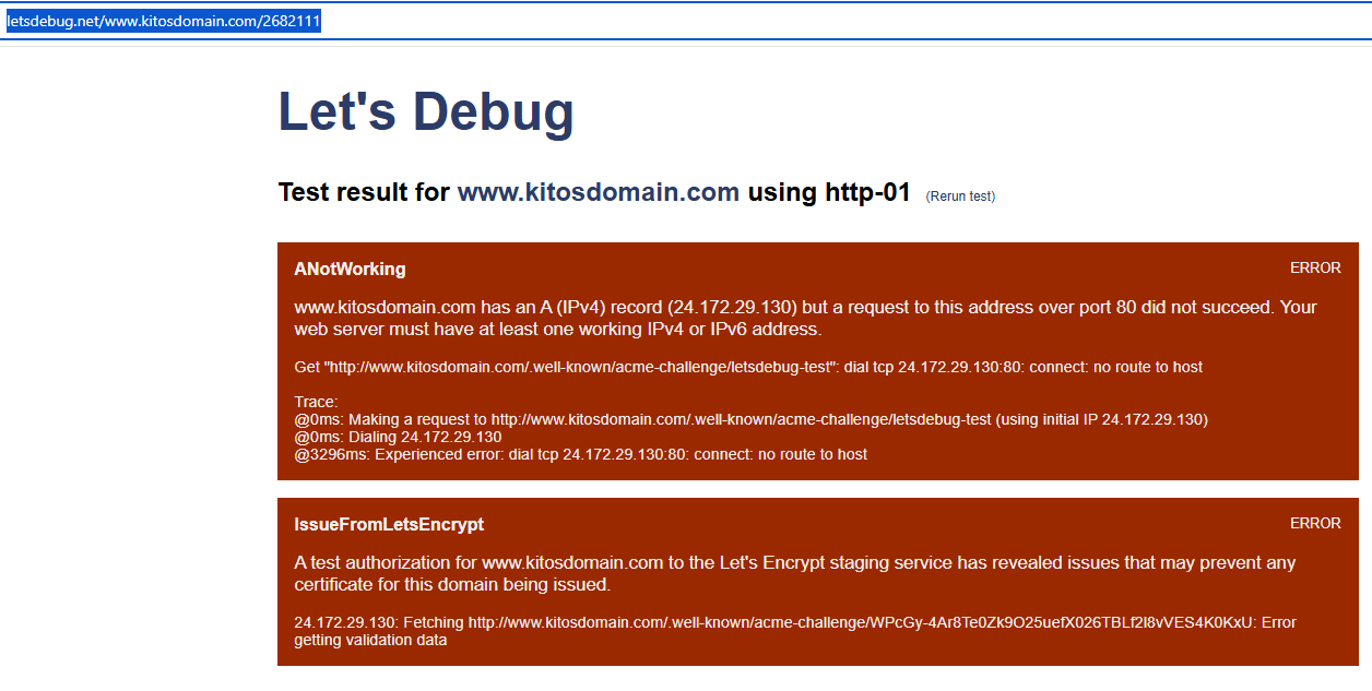

I am unable to create a certificate in Fedora 43 for my website. "Some challenges have failed."
My domain is: www.kitosdomain.com
I ran this command: sudo certbot --apache -v
blank to select all options shown (Enter 'c' to cancel): 2
Requesting a certificate for www.kitosdomain.com
http-01 challenge for www.kitosdomain.com
Challenge failed for domain www.kitosdomain.com
Certbot failed to authenticate some domains (authenticator: apache). The Certificate Authority reported these problems:
Domain: www.kitosdomain.com
Type: connection
Detail: 24.172.29.130: Fetching http://www.kitosdomain.com/.well-known/acme-challenge/TIm7sCdxnMQqAYxK6pAV1jEcjkzujqaCrm2LWg7ZNBg: Error getting validation
Hint: The Certificate Authority failed to verify the temporary Apache configuration changes made by Certbot. Ensure that the listed domains point to this Apacernet.
Ask for help or search for solutions at https://community.letsencrypt.org. See the logfile /var/log/letsencrypt/letsencrypt.log or re-run Certbot with -v for

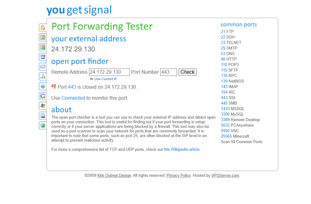

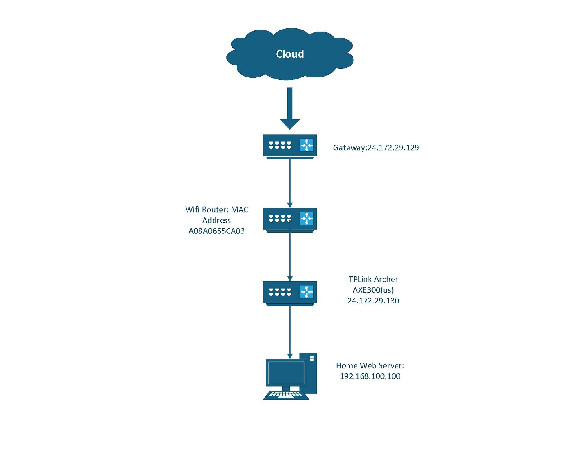

My hosting provider, if applicable, is: Spectrum (Charter Communications)

I'm unable to connect to your website, have you check that the IP address is correct (is your server still at 24.172.29.130) and have you allowed connections on TCP port 80.
Yes, Unless I have some configuration not working properly or port forwarding is not working properly on my router. It is saying as a new user I can't upload the network diagram and supporting documentation to get this issue resolved. I will try to find another way.
I'm currently getting ICMP host unreachable packets whenever I try to connect to 24.172.29.130:80.
Can your home web server access the Internet and what IP prefixes are you using for you LAN. you might have to add 192.168.100.0/24 to your router's routes.
Thanks for the response, based off the graphic which routers do I add that route to and for educational purposes why would I have to add a route if port forwarding is enabled (doesn't the router all ready implies that)?
Hello @otikkito,
Using the on line tool Let's Debug yields these results.
https://letsdebug.net/www.kitosdomain.com/2682111
And here Permanent link to this check report gets results of "Connection timed out" and "No route to host".
Yes, it can access the internet via NAT within my home router. Do you have another web server where I can test, send a packet, or try to reach behind my NAT and from the homeserver where I want to host?
Try this Open Port Check Tool - Test Port Forwarding on Your Router.
I sit behind a Spectrum cable modem --> Spectrum router --> TP-Link router with port forwarding enabled. The spectrum products, I don't know how much configuration is adjustable, and that is what I am troubleshooting. I can access the sites within my LAN but not externally (via the internet). I have an external internet remote jump box, which I can access some of the services listed in the graphic, but not web services.
