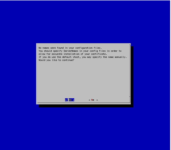

I would like to add that i get the following error when launching the command
