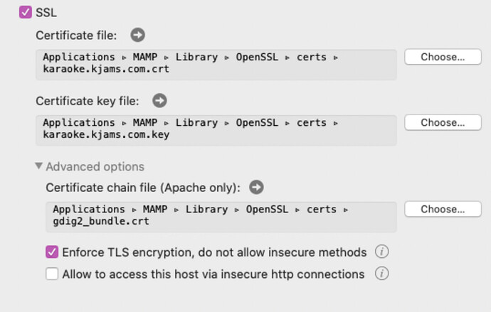

yes, MAMP PRO v6.2 (30167), but a confounding factor is that i CURRENTLY have certs from GoDaddy, but they'll expire next month, and i want to replace them with letsencrypt. so i'm not sure how to proceed, and there seems to be no doc on how to use certbot with MAMP ?

How did you install the current cert?

Sooooo NOT /etc/apache2/
Those locations are good to know.
We may need them for when you do get an LE cert.
But it seems you may have two different Apache servers running.
Which, of course, is messing with certbot --apache logic/flow.
We need to use: --webroot -w /and/use/the/right/MAMP/root/path/
