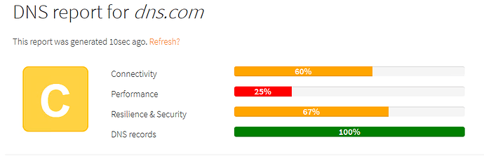

You can review your DNS performance and more at: https://dnsspy.io/scan/jubatv.net
And where your problem really is at: https://dnsspy.io/scan/dns.com
