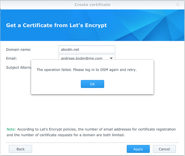

When I setup my Synology DS918+ I created a certificate that was for ds918.abodin.net, but now I want to change it to abodin.net only. I use Google Domains to host my domain, and I’ve setup a DDNS account for abodin.net and that works fine.
However, when I now want to modify or create a new certificate for abodin.net, it doesn’t get through.

Since I do the certificate in the Synology DSM GUI, the only message I get is that it failed and I should try to log out of the Synology DSM system and re-try.

Well, the tool in Synology is actually handling the whole setup of certificate.
See the attached images that shows the current one which I’d like to replace.

I now got it to work.
It seems to be connected with that I had entered additional names to be covered under the domain abodin.net, by adding www.abodin.net, ds918.abodin.net and drive.abodin.net.
When I left it blank to be created only for the abodin.net, it went through.
However, now when I visit www.abodin.net, the browser warns and it says that it is not trusted due to that the certificate is tied to abodin.net.
How can I make all my sub-domains be included in the certificate of abodin.net?

Yes, Synology is a "closed world", so you have only these options.
Yes, you need one certificate with many domain names.
But via https://crt.sh/ and Google Transparency Report - I can't find a certificate with many domain names.
Your box "Subject alternative names" is the correct place.
But it should be possible, right?
I read the info on this page…
Yes. Now you have one certificate with 4 domain names:
https://transparencyreport.google.com/https/certificates/bvQS3ujyPNRZO5HcZfAO%2FXsel4KOzE14zYOpvb5IMkA%3D
abodin.net
drive.abodin.net
ds918.abodin.net
www.abodin.net
Yep, now all 4 domains are working properly.
