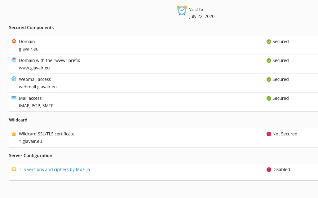

Keep getting the same error when i want to secure the wildcard domain.
First i receive this
Please wait while Plesk finishes adding a DNS record with the following parameters:
Record type: TXT
Domain name: _acme-challenge .glavair.eu
Record: **************************
So i go to my DNS settings in PLESK and enter what i must enter
And then when i click "Reload, i receive next message
Error: Could not issue a Let’s Encrypt SSL/TLS certificate for glavair.eu . Authorization for the domain failed.
