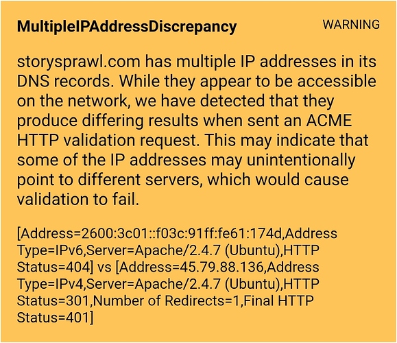

Hi, I've successfully installed before, and also renewed once before in July. Renewal started failing for me.
Command: certbot-auto renew --dry-run
Output:
Domain: <domain>
Detail: Invalid response from
<domain>/.well-known/acme-challenge/iBzlkeJb6BQ-j726sPPbYJvaE30kQjyzzTHiDHlwzDM
<ipv6>: "<!DOCTYPE HTML PUBLIC
\"-//IETF//DTD HTML 2.0//EN\">\n<html><head>\n<title>404 Not
Found</title>\n</head><body>\n<h1>Not Found</h1>\n<p"
I've never had to create that file before and it doesn't tell me how. My site is protected behind basic authentication anyway so the outside bot never would have been able to reach the site. I've also never create a TXT dns field. Why is renew asking me for this? In July, certbot-auto renew worked fine.
