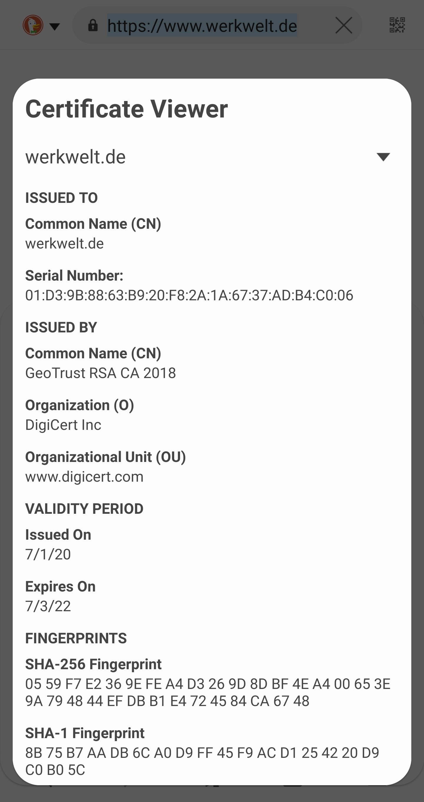

Examining the certificate with a browser by accessing the website, it says that it is valid until Dec, 19th, 2020.

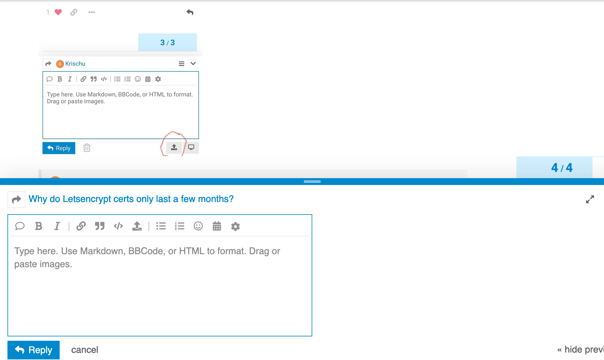

Can you upload that certificate file using the upload button (down to the right when creating a message) so that we can take a look at it? A certificate contains nothing private so you need not worry about privacy.
Thanks. Maybe I installed already an update mechanism without being aware of it when I first time installed Letsencrypt? BTW, I don't see an upload button when composing this message.

I just discovered the upload symbol in the tool bar (just not in the lower right corner :slight_smile:
(difference between computer vs. mobile?)

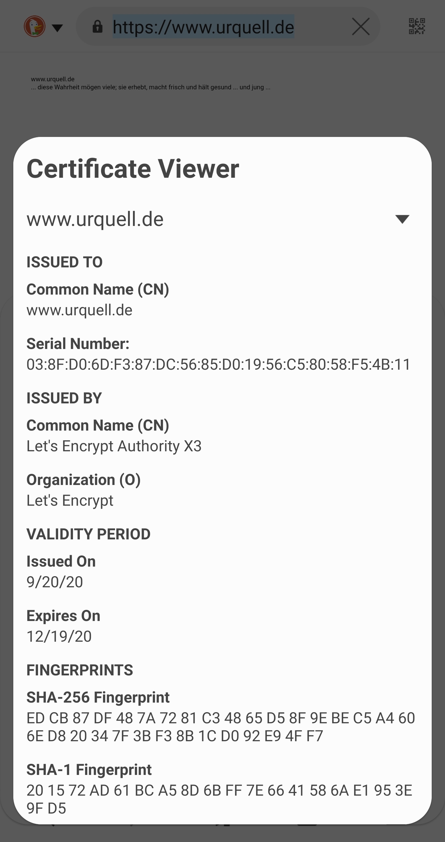

Looking here at the certificate with serial number 03:8f:d0...
Issuer: (CA ID: 16418)
organizationName = Let's Encrypt
Validity
Not Before: Sep 20 15:44:48 2020 GMT
Not After : Dec 19 15:44:48 2020 GMT
Looking here at the certificate with serial number 01:d3:9b...
Issuer: (CA ID: 62148)
organizationName = DigiCert Inc
Validity
Not Before: Jul 2 00:00:00 2020 GMT
Not After : Jul 3 12:00:00 2022 GMT
Yep. That's my fault. :upside_down_face:
