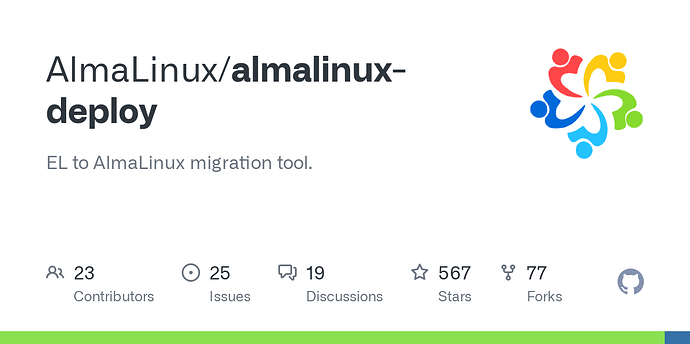

I recommend AlmaLinux over than CentOS Stream, you could consider their migrate tool
