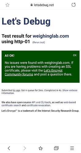

Your port 80 seems fine to me right now. Your redirects, on the other hand, have a problem. They go from http://www to https://www then back to http:// then back to https://.
You can have a perfectly working HTTP server without a virtual host: just a default host without even knowing about any hostname will do. It'll serve the same contents for every hostname provided by the HTTP Host header. But that doesn't work for the apache certbot plugin: it'll need a virtualhost to get the hostname(s) from, it'll need a virtualhost to install the certs in et cetera.
I got blocked from seeing the content in my browser due to the expired certificate. When I saw letsdebug return OK, I assumed that all was well on the far end of the redirect chain. That's my fault. I suppose this may be one of those cases where the error simply must be accepted as-is. Is there any way to confirm this error with an external tool (given that the cert is expired)?
