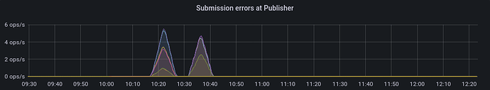

Looks like one of our two primary datacenters had two 5-minute spikes of latency communicating with roughly half of our configured CT logs, both around the problem time here of 10:17 UTC on 2022-08-11. It looks like it was transient.
If we get extended periods of log embedding issues we change our log publication list in response, but in this case it wasn't long enough of a period to trigger alerts.
If we fail to submit to CT, that order is dead: We've already issued precertificates, so we can't retry finalizing again. Subsequent calls should get an "already finalized" error.
The client will need to retry and create another order. Re-validating won't be needed since they should be cached still.
