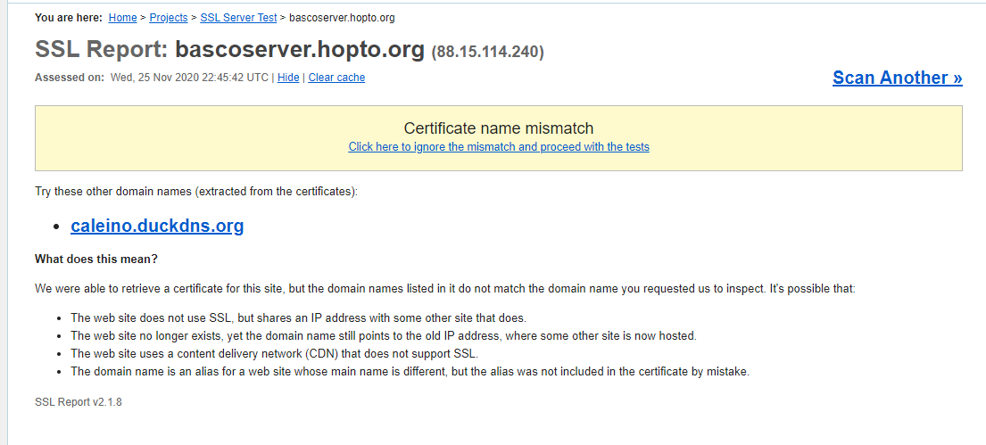

Up until now I have been running LetsEncrypt with DuckDNS with no problems whatsoever. The problem now is that I have created another DDNS that points to the same home network (bascoserver.hopto.org). Running SSL diagnostics reveals that the certificate is OK except for the fact that the domain names don't match. The DDNS address on the certificate matches the one on the other DDNS.

Not exactly. I already tried installing the certificate with
sudo certbot -d bascoserver.hopto.org
The certificate is created, but when I go to https://www.ssllabs.com/ It tells me that the certificate domain name doesn't match the domain. So the certificate name doesn't match bascoserver.hopto.org. It instead matches caleino.duckdns.org

Another question to add to @rip's: When you're done, do you want bascoserver.hopto.org to connect to one of your servers behind the firewall, and caleino.duckdns.org to connect to a different server behind the firewall? If so, you're going to have to assign an alternate port (e.g. :8443) to use with one of those hostnames. Also, that introduces some challenges in terms of which server is answering the challenges to get certificates.
You are spot on @jsha . It seems that both domains are serving the same content, and using the same IP (88.15.114.240) so it would be helpful to know more about @mbc99's vision of what the end result would look like. Lets get it right.
