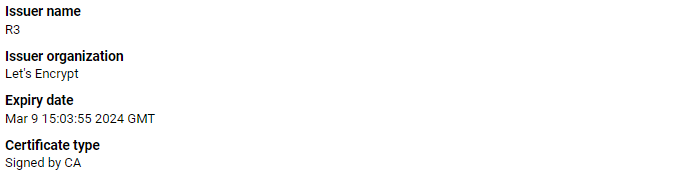

Some further evidences, the case when Chrome notices the certificate as self signed:
Some further evidences, the case when Chrome notices the certificate under Let's Encrypt:

That was for the R3 cert not the E1 cert Cloudflare got. (the latest R3 is not yet in crt.sh but is in censys.io)
The latest R3 issued cert expires Mar9 and I think that is all they are showing. The later example of the failing browser showed a localhost cert. And the Chome example working showed the E1 cert.
