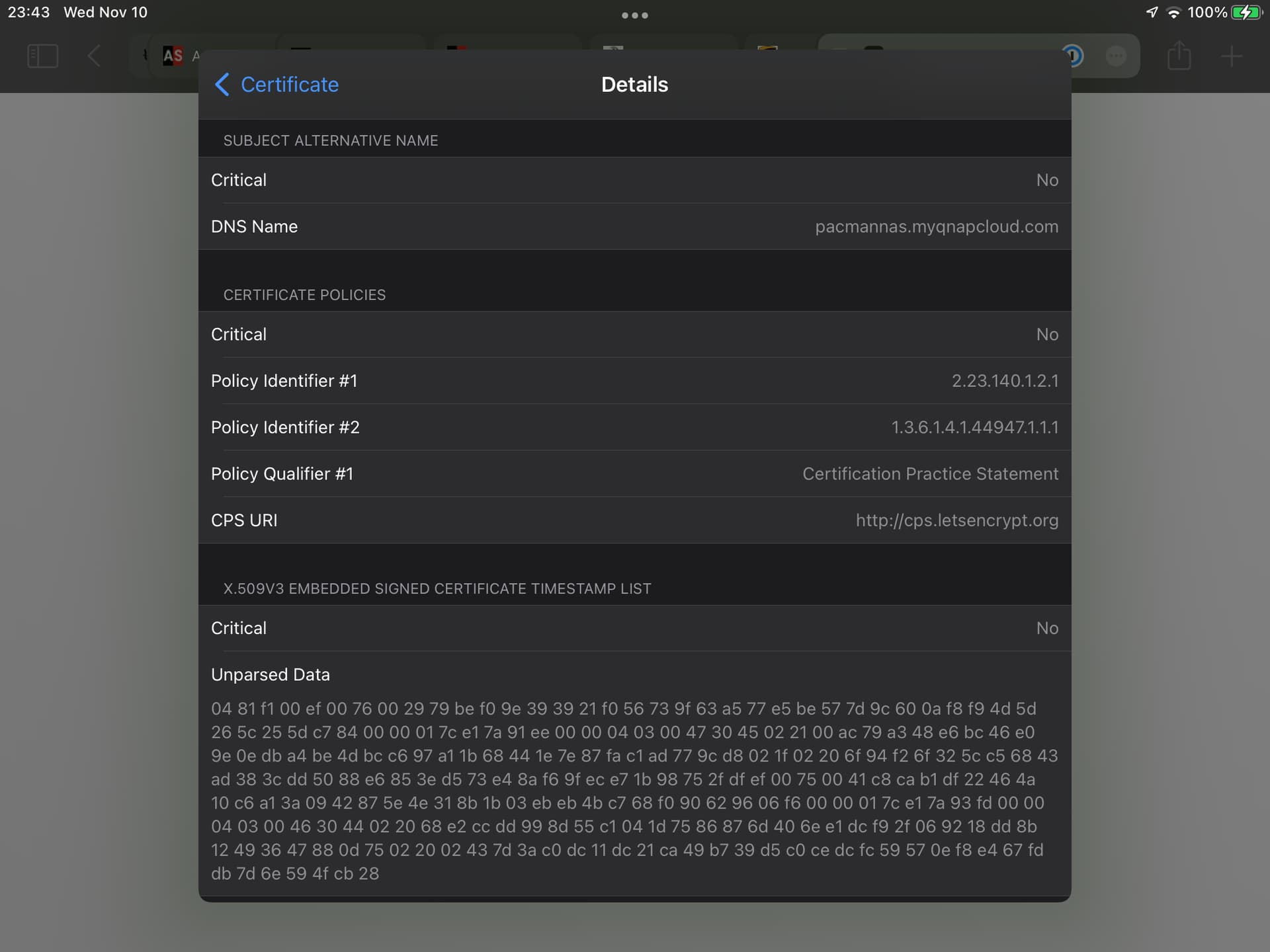

Why I initially said it expired is because of how I'm seeing it based on the following screenshot:
Now I don't know how to address this based on what you have provided me. That it is a "leaf" I don't understand, and how to get the whole chain to be sent is something that I have tried to research and find out. All that I did to install the certificate was essentially push a button on my QNAP NAS to get it installed. I've also included my logs below the screenshot.
