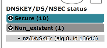

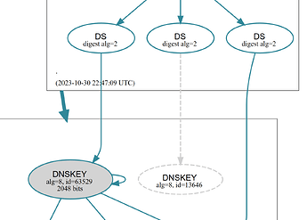

DNSViz does not reveal the problem at hand.
ID 13646 is one of three set in the root zone for .nz to use. .nz is using the other two without a problem - but not that one.
