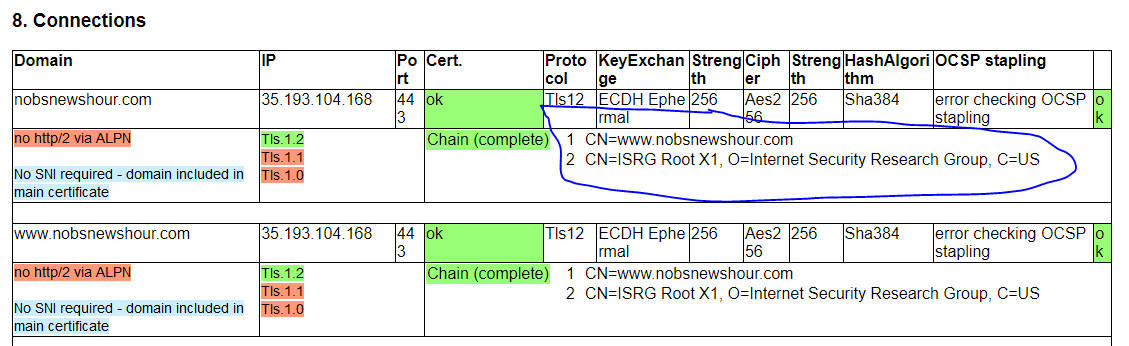

Chain not working - Chain issues Incomplete, Extra certs, Contains anchor

But checking your domain the problem is visible - see https://check-your-website.server-daten.de/?q=nobsnewshour.com#connections
  • There is your certificate and the root certificate. Must be your certificate and the Letsencrypt intermediate certificate
  • The output of my tool is wrong, that's not a complete / correct chain, so it should be red, not green.

 /home/drewandmikepodcast/htdocs/gd_bundle-g2-g1.crt
has the root certificate, not the intermediate. Open that file with an editor and check that.
Or
/opt/bitnami/letsencrypt/certificates/www.nobsnewshour.com.crt
should have two certificates.

That's
the missing certificate, so find the correct place.
