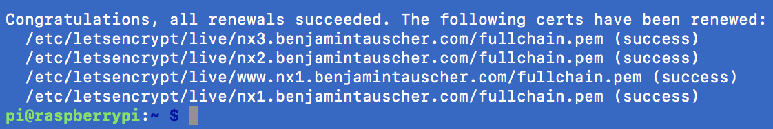

Seems like I cheered way to early…
I noticed that the certificate for nx1.benjamintauscher.com is still going to expire beginning of March. I repeated sudo certbot renew but still no effect. I also tried sudo certbot renew --force-renew but the result did not change:
Gültigkeitsdauer = Period of validity
Beginnt mit = Beginning
Ablaufdatum = Expiring date
So maybe still somethings wrong with the renewal conf, here are both files content:

Have you restarted / reloaded nginx ? (to use the updated certificates you have obtained)
Hi @DerPapst,
Your certs have been renewed:
CRT ID    DOMAIN (CN)                        VALID FROM             VALID TO                EXPIRES IN  SANs
94636395  nx1.benjamintauscher.com           2017-Feb-19 14:22 CET  2017-May-20 15:22 CEST  88 days     nx1.benjamintauscher.com
94636374  nx1.benjamintauscher.com           2017-Feb-19 14:22 CET  2017-May-20 15:22 CEST  88 days     nx1.benjamintauscher.com
                                                                                                        www.nx1.benjamintauscher.com
Are you sure you have restarted/reload your nginx server?. If you did it, show us the result of these commands:
openssl x509 -in /etc/letsencrypt/live/nx1.benjamintauscher.com/cert.pem -text -noout | grep -E '(Not After|DNS:)'
openssl x509 -in /etc/letsencrypt/live/www.nx1.benjamintauscher.com/cert.pem -text -noout | grep -E '(Not After|DNS:)'
Edit: Ups, I didn’t see the @serverco reply :wink:
Cheers,
sahsanu
No, sir! I totally forgot to do that! Sorry, my bet.
Everything worked fine, certs are all going to expire in exact 90 days. Thank you very much @serverco and @sahsanu!
