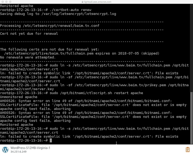

Hi @baim,
You said you expanded the current cert so the path used to create the symbolic links should be /etc/letsencrypt/live/baim.tv/ instead of /etc/letsencrypt/live/www.baim.tv/.
Double check the right path to your cert.

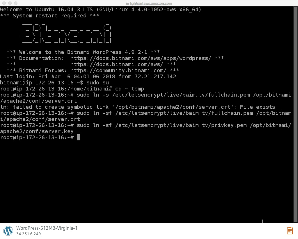

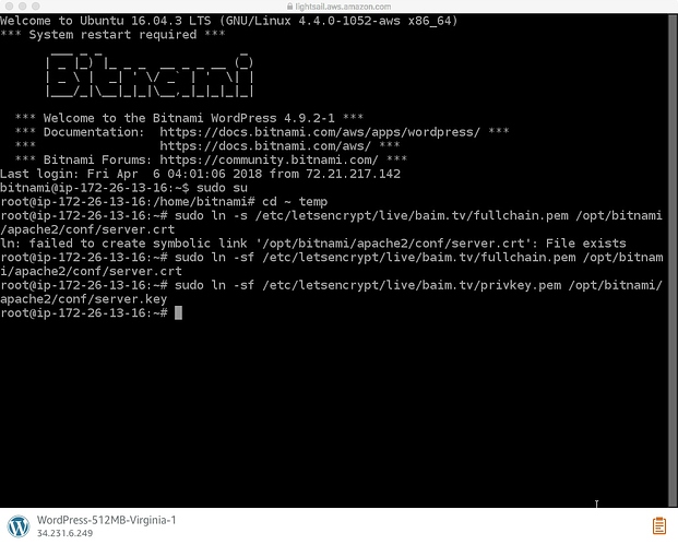

Ok, I have overwritten the certs using the following commands, with no errors:
sudo ln -sf /etc/letsencrypt/live/example.com/fullchain.pem /opt/bitnami/apache2/conf/server.crt
sudo ln -sf /etc/letsencrypt/live/example.com/privkey.pem /opt/bitnami/apache2/conf/server.key
What’s next?

Hi @baim,
You have a misconfigured rewrite rule in your VirtualHost (the one used for 443 port) or you have that rewrite rule in some .htaccess file. Whatever, it is generating a loop, right now when you try to access http://baim.tv it redirects to https://baim.tv and it redirects to http://baim.tv and so on…

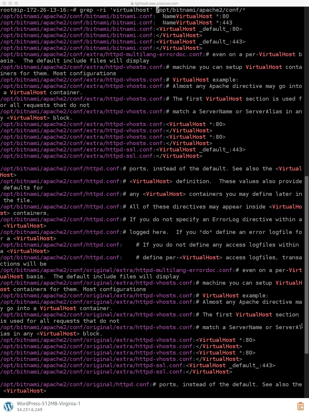

Sorry but I don’t understand the whole picture here, you did only the steps you have posted above that are using the default VirtualHost on port 80 and it is using the DocumentRoot /opt/bitnami/apache2/htdocs but issuing the certificates you specified the webroot path as /opt/bitnami/apps/wordpress/htdocs/ so… where is the conf for your domains baim.tv and www.baim.tv?
grep -ri '/opt/bitnami/apache2/htdocs' /opt/bitnami/apache2/conf/*
Ok, awesome! Here are the results of the scripts:
You mistyped the command I posted, you wrote cong instead of conf.

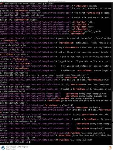

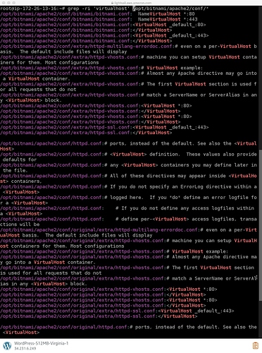

Show the output of these commands:
grep -ri '/opt/bitnami/apps/wordpress/htdocs/' /opt/bitnami/apache2/conf/*
grep -ri 'virtualhost' /opt/bitnami/apache2/conf/*
grep -ri 'servername' /opt/bitnami/apache2/conf/*

no, put the entire command:
Also, show the output of these commands:
