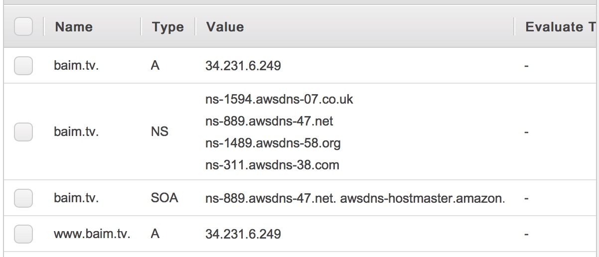

Hello,
As far as I can see, it looks like the record is there. What am I missing?
Thanks!
Those all refer to baim.tv, not www.baim.tv.
Oh ok! So do I need to add them both or do I change the one to add www?
If you want people to be able to access the service regardless of which name they type in, you need to add both.
Oh, ok, this is new for me, so thank you for your patience. I have added another DNS record. Is this correct now?
Yes, but apparently your nameserver doesn’t know about it yet for some reason. Did you commit this change?

As far as I know I did. How can I check?
Not sure what you mean.
the last line in your dns02.jpeg file is the problem
the NS entry for www.baim.tv
ok, i deleted it.does this look correct now?
the picture looks good
but it hasn’t yet propagated out to all the DNS servers: http://dnsviz.net/d/www.baim.tv/dnssec/
