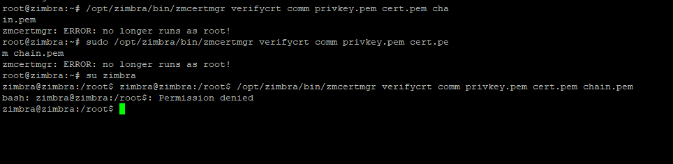

the certbot renew command worked fine, returning the renewal to me, but on the zimbra server, it still does not see the renewed one but always the expired one; in a guide that I am following, at the command / opt / zimbra / bin / zmcertmgr verifycrt comm privkey.pem cert.pem chain.pem I get the error:
root @ zimbra: ~ # / opt / zimbra / bin / zmcertmgr verifycrt comm privkey.pem cert.pem chain.pem
zmcertmgr: ERROR: no longer runs as root!
root @ zimbra: ~ # su zimbra
zimbra @ zimbra: / root $ / opt / zimbra / bin / zmcertmgr verifycrt comm privkey.pem cert.pem chain.pem
** Verifying 'cert.pem' against 'privkey.pem'
ERROR: Can't read file 'privkey.pem'
ERROR: Can't read file 'cert.pem'
What can I check to correct this error? thank you all for your availability
You probably need to run the commands as root or by using sudo.
hello and thanks for the reply ... that command can only be started by the zimbra user
Weird, because the error message: [quote="vettalex, post:1, topic:161512"]
[/quote]
..suggests the zmcertmgr expects to be run as root.
Anything else I don't know. No experience with Zimbra luckily.
You made me doubt, and then I ran the command both as zimbra and as root and as sudo ... but nothing unfortunately
It seems you were trying to run the command zimbra@zimbra:/root$ which doesn't work of course. Probably a copy/paste error from the line above the su command.

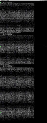

Now also place the inside of each file ... I would not like there to be known errors in the code:
