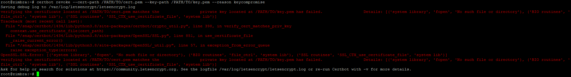

you can revoke old certificate private key with
certbot revoke --cert-path /PATH/TO/cert.pem --key-path /PATH/TO/key.pem --reason keycompromise
then use certbot renew --force-renewal for this time(and this time only, don't put that on cron) . as timer didn't run out but you'll have to run the renewal process.

you should put your certificate's path to revoke. you left /PATH/TO/cert.pem and /PATH/TO/key.pem as is
but looks like LE staff is come to revoke the certificate so maybe skip the revoke and just force renew the certificate and let staff to the revocation for you :stuck_out_tongue:

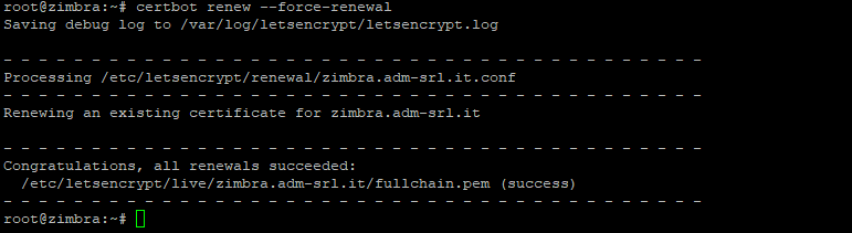

Ok, so I'm waiting for LE? or can I already do a renew?
you can renew the certificate already with --force-renewal parameter
revocation will be done per certificate
perfect, now I have a new certificate, can you confirm it for me?
You would need to insert it into Zimbra.
That's right, so I move the files to the new folder and redo the command under zimbra and see how it goes
