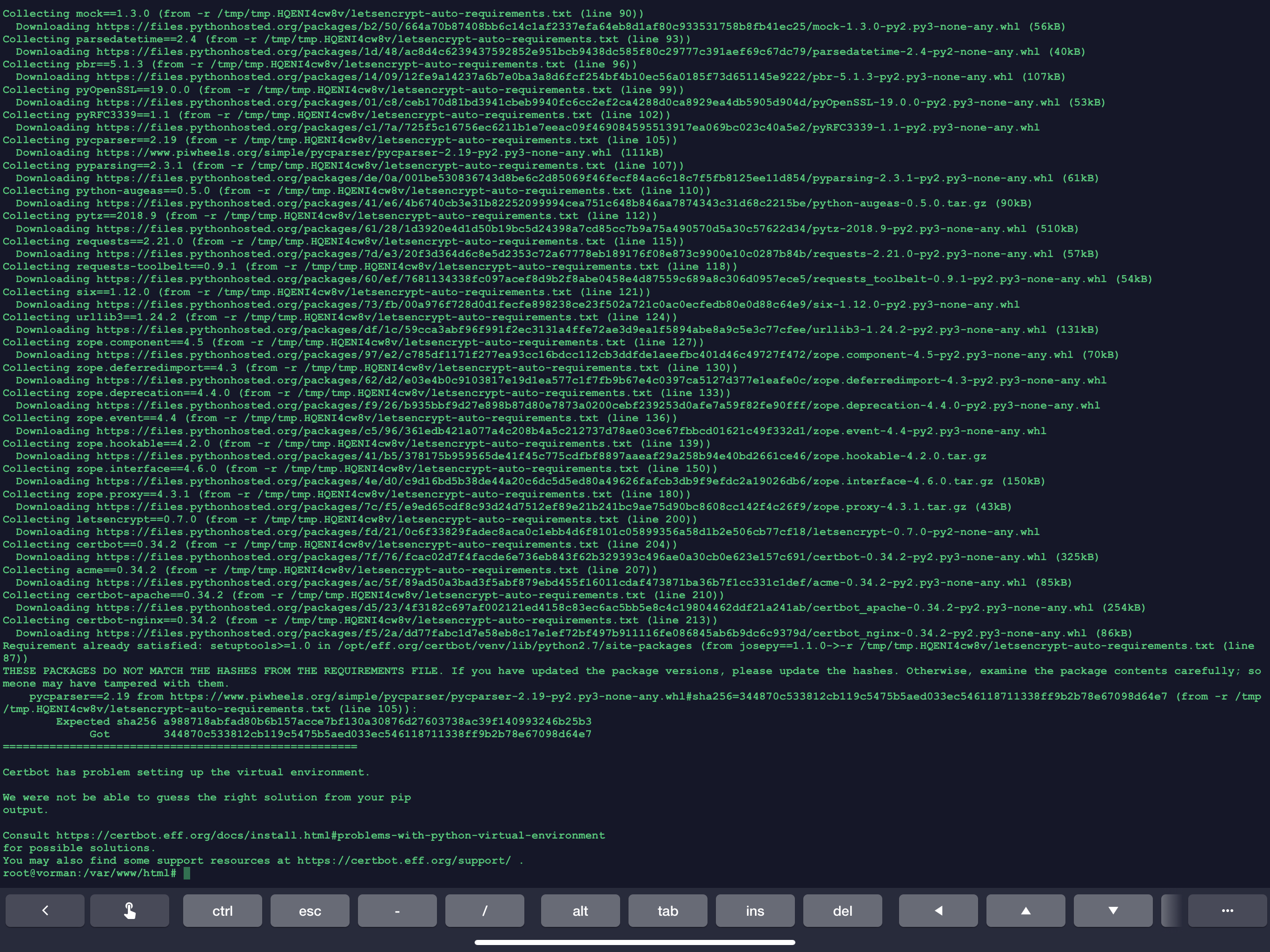

Issue renewing certificate
Done this several time. Doing this from hotel this week and not able to renew
Is that a Raspbian host?
Have a read over Certbot-auto certificates fails while installing phyton packages with THESE PACKAGES DO NOT MATCH THE HASHES , in particular the bit about pip using piwheels.
I am on Debian stretch but this is first time i run into this issue during renewal .
Not clear what is the work around
The reason I ask about Raspbian is that I can see https://www.piwheels.org/ referenced in your screenshot, which is what that issue is about.
Normally, Debian Stretch does not use that - it's specific to Raspberry Pi distributions. So I think it is more likely that you are using Raspbian or something similar.
The workaround is this specific comment:
Let me correct I am in raspian stretch but first time I get this error
Workaround work like a charm thanks
