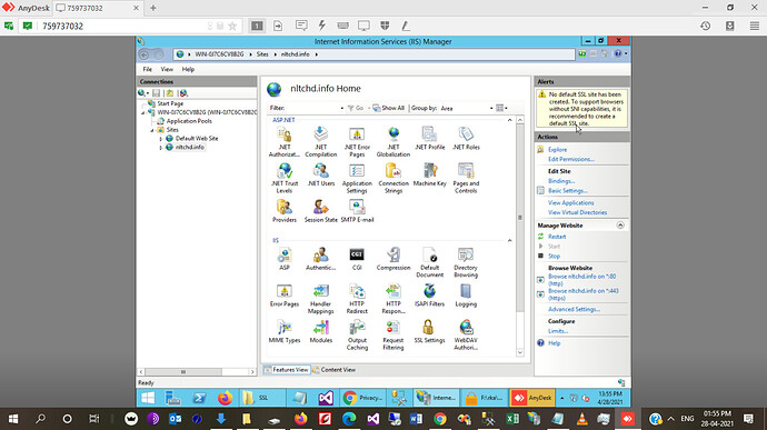

Hi @ritukamal
share a screenshot of your bindings menu and a screenshot of that specific https binding.
There you see the missing step.
Check "Require Server Name Indication".
That's required that this binding is used.

DONE and tried restarting IIS it gives following
Informations are required
What says View (must show the certificate).
My browser sees a "Fortinet" certificate. May be Fortinet has added the certificate to that list.
Or you have another instance in front of your IIS, so that Fortinet-Instance answers.
can u share what your browser is showing.
