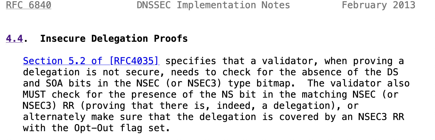

The zone seems to fail the NS-bit requirement:
/redacted/
Could be. Although it seems the Unbound code in val_nsec.c seems to be checking for a NS RR (LDNS_RR_TYPE_NS) and not an NS bit? But as I said earlier, I'm not sure if the code I've quoted above is even an error or just a warning...
