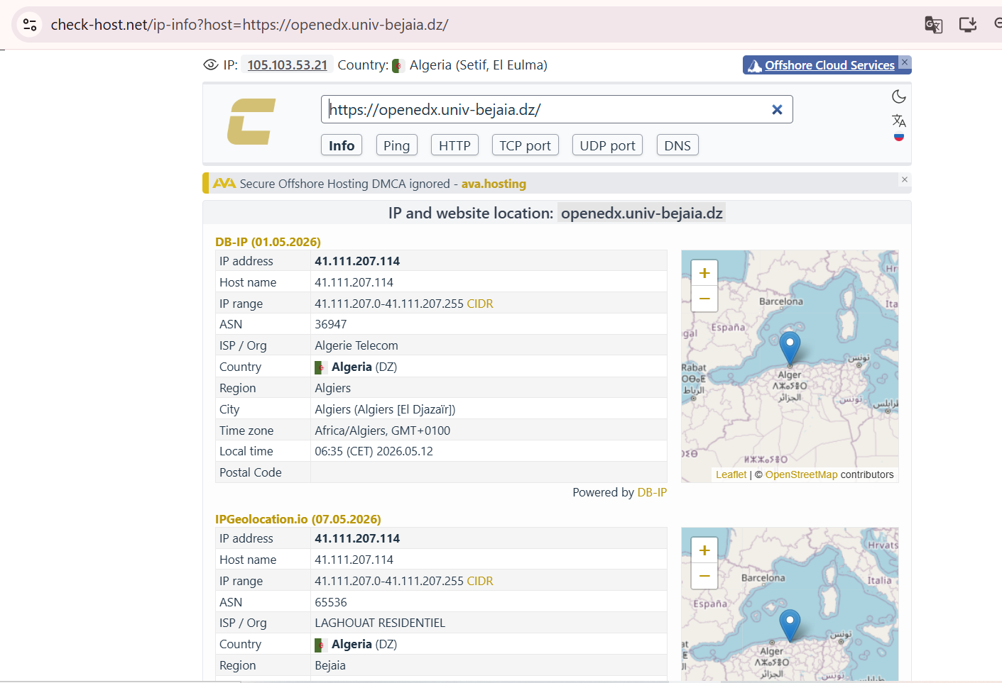

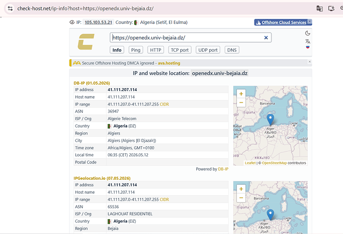

The site is accessible from where I am, but not in other countries. In my opinion, if it was a firewall issue, the site wouldn't be accessible at all. I think it's a DNS problem, but how can I be sure?
It might be a firewall (or router, or other network device maybe even before getting to your ISP) that blocks traffic selectively. In order for Let's Encrypt to be sure that you control the name as seen from everywhere on the Internet, they need to check from multiple places on the Internet.
