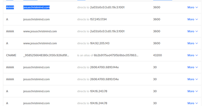

i have added the A and AAAA record to point to my digital ocean ubutu droplet. am using digital ocean directly
if u enter the domain it will show you a nginx server as a symbol that the A record is inserted well
Adding is not enough. They have to be the only ones present for that "dns label" (the single domain/subdomain)
that is a picture of how my configuration looks
the other record are not deletable
If you are not using Cloudflare anymore you have to remove the AAAA records pointing to 2606:4700:.... and the A records pointing to 104.16.x.y
Is that the cloudflare panel or the digitalocean one?
This is where the problem is coming from
These Records seems permanent because they seems not removable because they are managed by the digital ocean app.
I was refused removing those A and AAAA records
I don't know digitalocean too well. Maybe you can remove them by disabling some cloudflare integration? (make sure you're not breaking other websites and droplets in doing so)

I don't think anything is wrong with the DNS records.
From what I remember, DigitalOcean use Cloudflare infrastructure for their DNS hosting, and jesuschristmind.org looks like an ordinary domain with the Cloudflare proxy enabled.
You have a fairly old version of Certbot and there is a fix relevant to --nginx and Cloudflare in Certbot v1.13.0. If you can, I recommend installing the Certbot snap and try using it instead.
If you can't do that, you might have to set your Cloudflare encryption setting to "Flexible", but I'm not sure whether that's accessible from the way DigitalOcean have integrated things.
But... there are two cloudflare IPs and a DigitalOcean IP... how is that supposed to work?
(oh, I get it now. ns{1,2,3}.digitalocean.com points to cloudflare IPs.)
Ah, you are right, there's a mixture of IPs.
Those non-Cloudflared IPs (164.92.205.143 and 2a03:b0c0:3:d0::19c3:1001) don't seem to host the website in question at all. The IPv4 address is just a blank nginx server and the IPv6 address doesn't even seem to be online.
The Cloudflare IP addresses, on the other hand, do serve a valid website.
Is @udunanka trying to set up a second server? I am not clear on what the role of this second droplet is, if it's not hosting the current website?
Neither am I.
I assumed the spurious IPs were the cloudflare ones. If they're the right ones, I might start to suspect that this is some kind of automatic digitalocean-cloudflare integration for this droplet.

They "work" because CloudFlare is handling those IPs (and those certs):
Addresses: 2606:4700::6810:f44e
           2606:4700::6810:f34e
           104.16.243.78
           104.16.244.78
Aliases:   www.jesuschristmind.org
