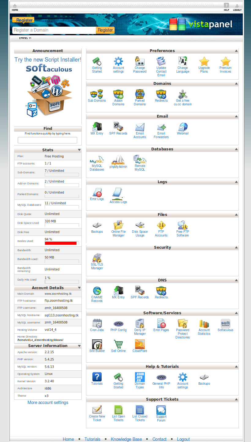

Also, they say they offer the “VistaPanel” as a control panel. You can access that panel through your Android phone I’d think, correct? Or do you use some kind of app?
The screenshot of that “VistaPanel” on their site shows a “SSL/TLS manager”, so that’s promising!

@Osiris was wondering if the “SSL/TLS manager” feature in the control panel offers a way to get the hosting provider to obtain the certificate for you. Is that possible, or is the “SSL/TLS manager” the part that you posted a second screenshot of (that displays your private key and CSR)?
