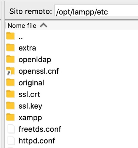

Thanks 9peppe, just to be sure if I wrote it right:
certbot renew --cert-name "123.online-server.cloud" --apache --apache-bin /opt/lampp/bin/httpd --apache-server-root /opt/lampp/etc/httpd.conf
it should be like this. you can add --dry-run to make your experiments and check if it works.
I don't know if that's going to be enough because that directory is not exclusive to apache.
Thanks 9peppe, you helped me a lot with success from the beginning of my project, but this time I think I have few problems to solve first.
