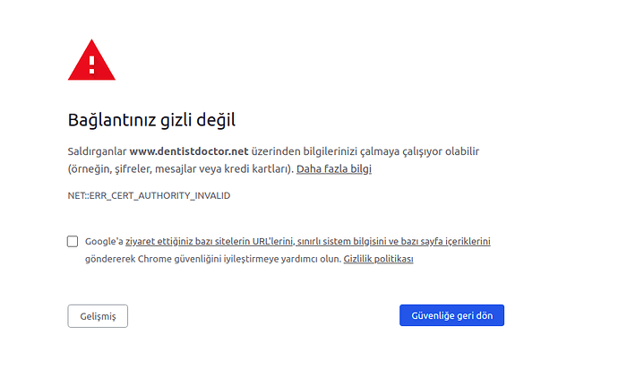

edit the runtime code and build it again. But the output is as follows
Error creating new order :: too many certificates already issued for exact set of domains: dentistdoctor.net: see https://letsencrypt.org/docs/rate-limits/
2019-11-13 14:16:18,499:ERROR:certbot.log:An unexpected error occurred:
2019-11-13 14:16:18,500:ERROR:certbot.log:There were too many requests of a given type :: Error creating new order :: too many certificates already issued for exact set of domains: dentistdoctor.net: see https://letsencrypt.org/docs/rate-limits/
Looks like you have created 5 identical with 2019-11-06, so that blocks. Wait some hours.
And don't create more then one certificate. Do you save the certificate outside of your docker so you can re-use the certificate? If not, that's wrong.
