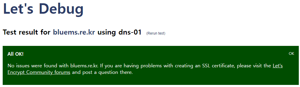

I wait 10 minutes after add/modify all txt record, test below sites and typing enter.
I test letsdebug: (tested: Let's Debug (letsdebug.net))
and query txt record: (tested: server-daten.de)
Both values need to be there at the same time, in separate TXT records on the same _acme-challenge.bluems.re.kr domain.
  • nWSnQBxtZVEMq5dQqzrqHG5c6kbonk1-hi8pLSmqpLs
  • L2JzC5zmVGx7b1u_3_-AAmubfNiw4oJ9zpi0Rqw8NEk
From the look of your output, you are removing the first TXT record when you add the second one.
