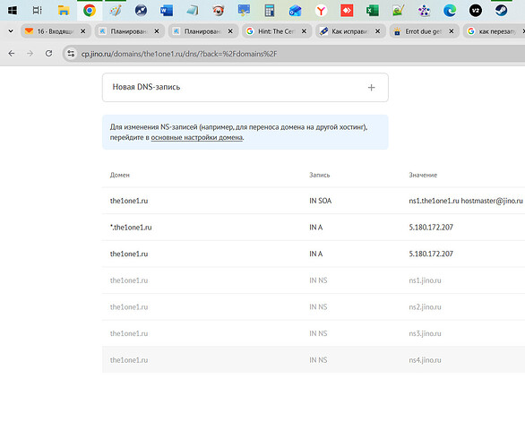

I don't know why maybe something with dns please look at screenshot
@Den It is up to you to configure your system correctly. If your plan is to use Apache then you need to find out why nginx is responding instead. You did not even answer many of the questions on the form you were shown for me to make some specific suggestions.
It is not just Let's Encrypt affected. Anyone making requests to your domain are getting a reply from nginx.
An HTTPS request to your domain uses an invalid cert. But, ignoring that it shows this from a system running nginx. You should focus on why this is happening
