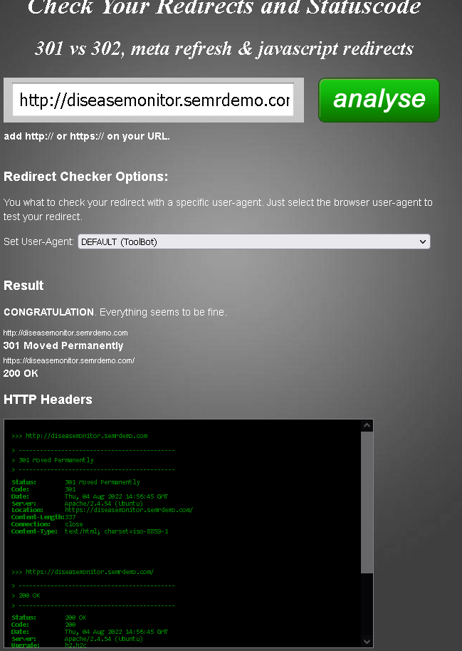

You should redirect http requests to https. Who or how did your Apache config get updated?

I did that.
Will correct it now.

Hmm. My rewrite was there. servername was incorrect.

I just corrected is 20 seconds ago.
Yeah, I see it redirect fine.
curl -I http://diseasemonitor.semrdemo.com
Date: Thu, 04 Aug 2022 14:55:35 GMT
Server: Apache/2.4.54 (Ubuntu)
Location: https://diseasemonitor.semrdemo.com/

Yes you did as shown here:

I can se it. Looks good to me.
