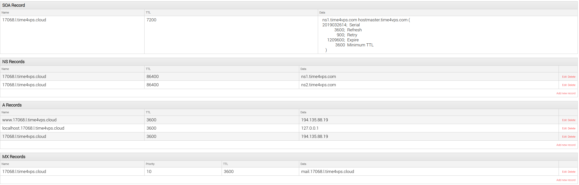

I’ve looked at some other peoples solutions and have come up blank. here is a screenshot of my Nginx config and A name records.
Any help very appreciated.
It looks like that isn’t the active DNS setup.
time4vps.cloud uses these nameservers:
time4vps.cloud.  86286  NS  ns1.serveriai.lt.
time4vps.cloud.  86286  NS  ns2.serveriai.lt.
time4vps.cloud.  86286  NS  ns3.serveriai.lt.
time4vps.cloud.  86286  NS  ns4.serveriai.lt.
17068.l.time4vps.cloud isn’t a separate zone and isn’t delegated to ns1.time4vps.com and ns2.time4vps.com.
Either you aren’t accessing the right DNS control panel, or the delegation hasn’t been set up yet.
So
ns1.serveriai.lt.
is their nameserver hostname and not
ns1.time4vps.com
like they have it set as default to?
nsX.serveriai.lt are the nameservers for time4vps.cloud. They could delegate 17068.l.time4vps.cloud to nsX.time4vps.com, but they haven’t.
I don’t know what control panel you’re using, or why it has the records it does.
Maybe they’re going to delegate 17068.l.time4vps.cloud to nsX.time4vps.com in the next few hours. Maybe it’s just wrong.
Ok guess I need to take it up with my provider then. Thanks a ton for the help you guys are great and responsive.
What kind of tools do you guys use for finding this info and troubleshooting?
I’m using the panel from their site btw.
