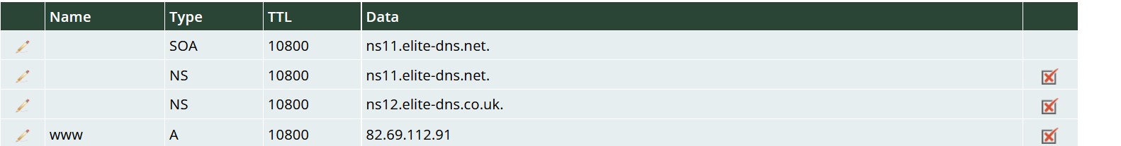

The setting are the same for sheffieldweather.co.uk
Looked at the dns zone file and there is a differance between the two. www.sheffieldweather.co.uk has an A record with the ip address as well while www.sheffieldweather.net only has an A record for the host name.
Sadly I can't see a way to edit or add the record so raised a ticket.

Now backup and running properly. Funny how I managed to get a certificate for sheffieldweather.net before though. I hadn't changed anything from the time I created it.
