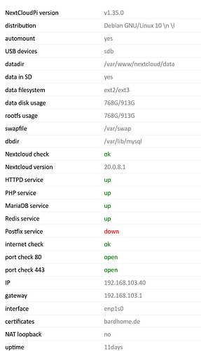

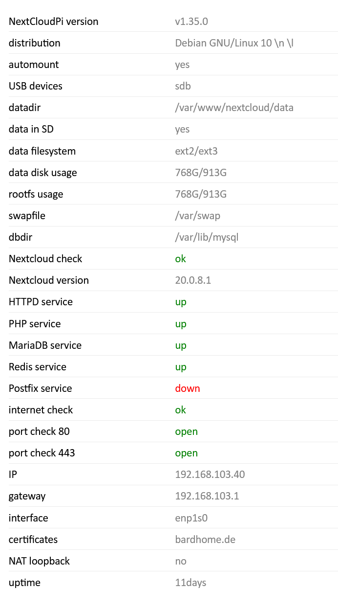

It worked for several years, now not anymore. I have not change anything, but nextcloudpi updates itself. Probably there something changed, but I cannot figure out what. I have not setup some sort of firewall.
The system and the router tell me the port should be open:
But some portscanner says its closed, strange...
