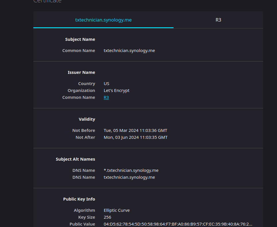

Here is what I get when I click "View Certificate":
The Synology NAS is using Synology's DDNS service (hence the synology.me address).

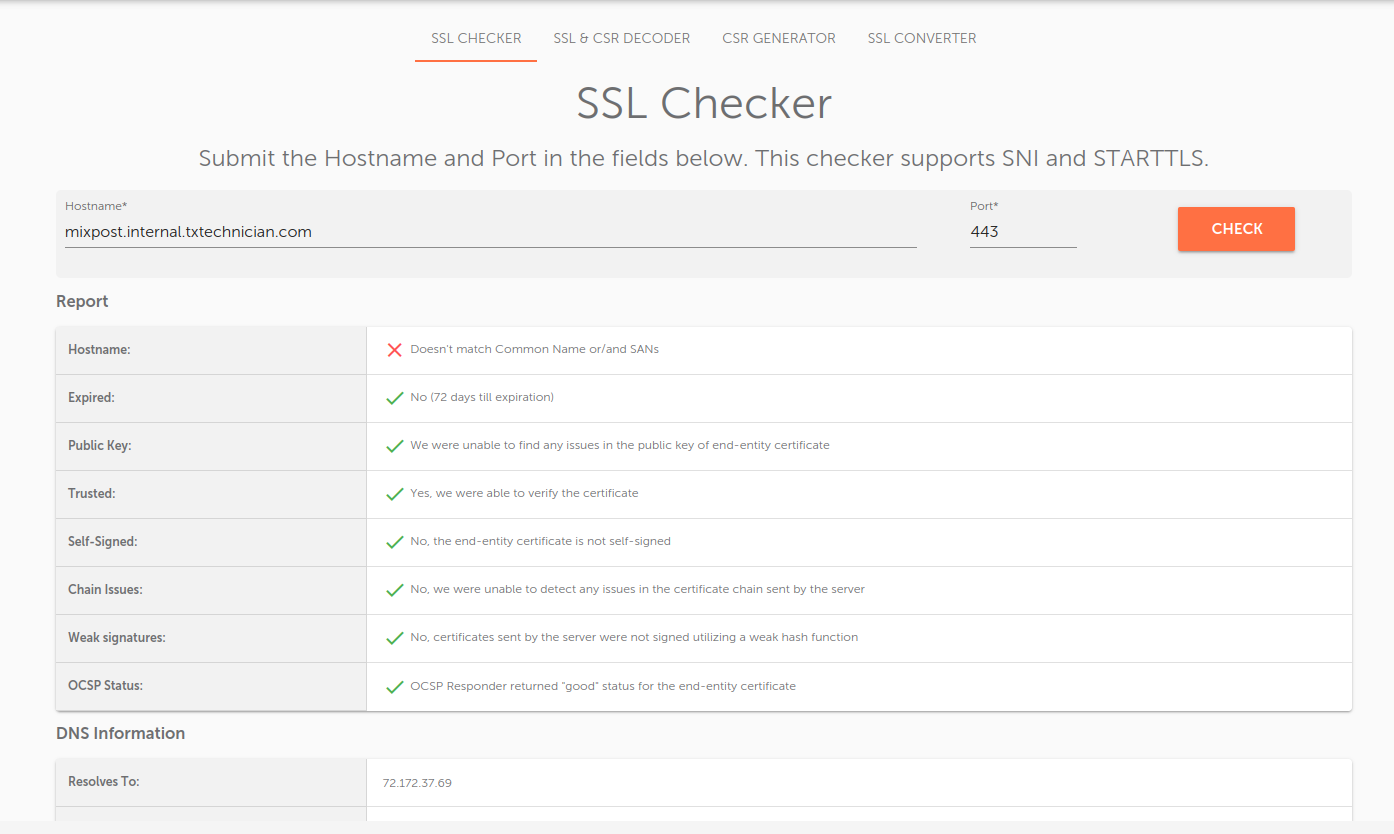

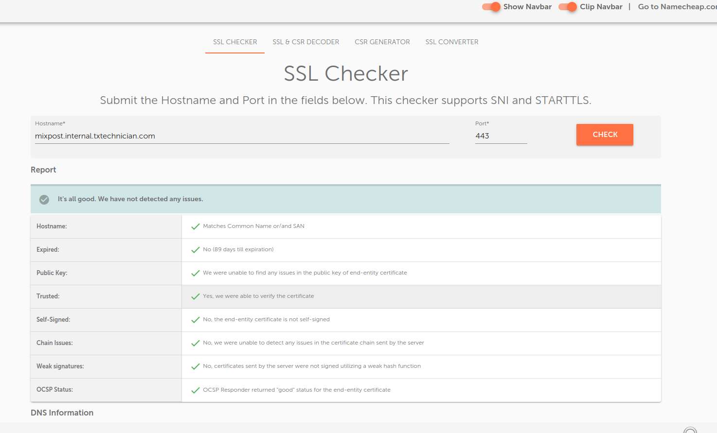

I ran an ssl checker with the nas port enabled and disabled:
Enabled:
Disabled:

Whatever system terminates TLS (HTTPS) needs to have a cert with a name matching the domain in the URL. HTTPS by default works on port 443.
Looks like port 80 (HTTP) is handled by your nginx 1.18 but port 443 by Synology.
General system config isn't really our focus here. You might find others at Synology forum with similar situation.
But, one option would be to have your Ubuntu nginx get all port 443 (HTTPS) requests and have a cert for each of your domain names (synology.me and .com). Then make a server block for port 443 for synology.me requests and proxy those to your Synology on your local network using HTTP (no cert required for http).

I figured it out. I was trying to run two servers behind the same public IP on the same port.
The NAS had the first in line firewall rule. Which is why it was not working.
I disabled the Ubuntu Server and then used the Synology NAS to get a cert for the appropriate domain. And then used NGINX in the NAS to direct traffic to the Ubuntu server...
