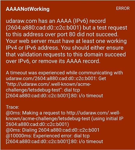

why
Why certbot no give IPv6 error!?
You can sometimes get away with having a broken IPv6 address.
Usually this is when the IPv6 address just times out and does not respond at all. In these cases, Let's Encrypt will fall back to the IPv4 address, if available.
However, broken IPv6 addresses will definitely cause trouble if an error occurs at any moment after a connection is successfully established, or if the IPv4 address does any form of HTTP redirect.
In general, yes, the OP should fix their IPv6 address, but I'm skeptical on whether it's the root cause here.
I concur in thinking it is not the root cause, which is why I overlooked checking for a functioning IPv6 in the first place. :wink:
For what it's worth I only tried enabling ipv6 because I read in some other threads that I might need to enable it to fix this issue. So it was failing before as well. I'll fix up the ipv6 configuration today, but don't think that's the root cause either :disappointed:
