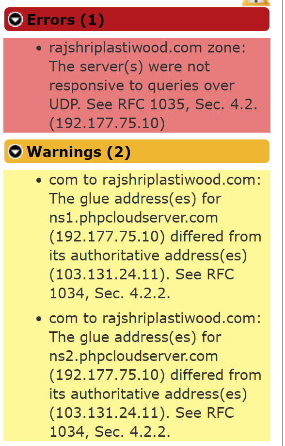

The .com nameservers say that your DNS server is ns1.phpcloudserver.com & ns2.phpcloudserver.com which are both (!) at 192.177.75.10. But that IP isn't actually responding.
What you should do is configure your DNS servers with your registrar, and ensure that any glue records needed are correct. But we don't know what your correct configuration is supposed to be.

The problem seems to be that ns1.phpcloudserver.com etc are not responding to UDP queries like a normal DNS server would (but they are answering on TCP). You could raise this with them (assuming you are not the administrator) or you could move to a different DNS provider like cloudflare etc.
[edit, a yep, one of the "glue" records is a private IP]
Probably because of the wrong "glue" records as Peter noted earlier. From the DNSviz link he posted
For example, using the IP address for your ns1 name server works. But, using the IP in the glue record fails. This is the first thing you should fix
