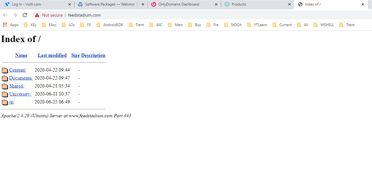

Certificates renewed but browser still says "Your connection is not private" bad https certificate
https://crt.sh/?q=feedstadium.com
My domains are:
feedstadium.com and memecreatures.com and www.feedstadium.com and www.memecreatures.com
certbot renew
https://ibb.co/JsWgLjM
apache2
ubuntu 18.04
a vultr.com VPS solution
yip
I have webmin, froxlor, phpmyadmin, LAMP, etc.
certbot 0.31.0
I’m having trouble with the browser recognition. I have read other posts here pertaining to
an-authentication-script-must-be-provided-with-manual-auth-hook-when-using-the-manual-plugin-non-interactively
and
pluginerror-an-authentication-script-must-be-provided-with-manual-auth-hook-when-using-the-manual-plugin-non-interactively-skipping
and
the-manual-plugin-is-not-working-the-error-was-pluginerror
but they basically say:
  1. turn off apache2 and retry certbot renew
  2. if you manually installed certificates then you must manually renew like so: “certbot certonly --manual -d '*.therightdoctors.com'”
  3. try --dry-run to see errors
and I tried those. The errors in dry-run just say that the certificates don’t need to be renewed.
Also a point to note, when I ran certbot renew it created new certificates under the names feedstadium.com-0001 and memecreatures.com-0001 in:
etc/letsencrypt/renewal and also in
etc/letsencrypt/live
but it doesn’t seem to have updated the certificates, but rather just created new ones.
Also I tried manually renewing by typing in:
certbot certonly --manual -d '*.feedstadium.com'
and it said that it successfully updated the certificate. But then the browser still doesn’t work, even after restarting apache2, and also, a new error popped up when running certbot renew again. This is the new error:
Additionally, the following renewal configurations were invalid: /etc/letsencrypt/renewal/feedstadium.com.conf (parsefail)
How have I messed this up :)?
Also, I have a custom apache conf:
DocumentRoot “/var/www/html/feedstadium.com”
ServerName www.feedstadium.com
Redirect permanent / https://www.feedstadium.com
DocumentRoot /var/www/html/feedstadium.com ServerName www.feedstadium.com SSLEngine on SSLProtocol +TLSv1 +TLSv1.1 +TLSv1.2 SSLCertificateFile server.crt SSLCertificateKeyFile server.key SSLVerifyClient none DocumentRoot "/var/www/html/feedstadium.com" ServerName feedstadium.com Redirect permanent / https://feedstadium.com DocumentRoot /var/www/html/feedstadium.com/ ServerName feedstadium.com SSLEngine on SSLProtocol +TLSv1 +TLSv1.1 +TLSv1.2 SSLCertificateFile server.crt SSLCertificateKeyFile server.key SSLVerifyClient none `
Thanks.

Thanks. I did certbot, and it seems to have given me new certificates for feedstadium.com and www.feedstadium.com.
But the browser issue still remains.
I tried restarting apache2, no effect. What else needs to be done?
It reported this:
(It also reported the old certificate underneath this report).
If you don't have a working configuration, Certbot can't create working vHosts, that's expected.
But checking your domain - https://check-your-website.server-daten.de/?q=feedstadium.com - you have created two certificates
Let's Encrypt Authority X3 2020-08-03 2020-11-01 www.feedstadium.com - 1 entries duplicate nr. 1
Let's Encrypt Authority X3 2020-08-03 2020-11-01 feedstadium.com - 1 entries duplicate nr. 1
and both connections are secure.
So there is no problem visible - you have two vHosts, not only one. Untypical, but possible.
Oh. I will later search on how to resolve this down to the www’s only.
Why does it sometimes show up in my browser as “ok” and other times it’s still a non-valid certificate warning?
Clear your browser caches. It looks good from here.
